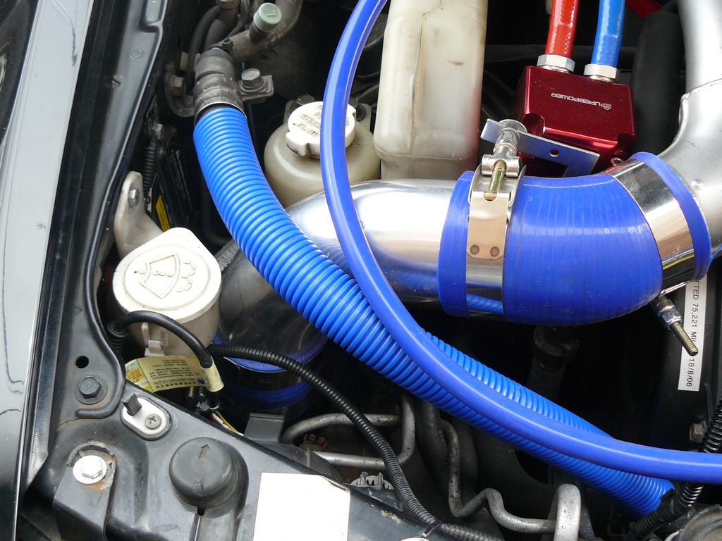

Time for pictures and description (some of pictures just for illustration purposes):
1. "metal weld" adhesive
2. prepared pipe for vacumm outlets (overall view)
3. prepared pipe for vacumm outlets (inside view)
4. pipe with done vacuums
5. hard pipe next to coolant expansion tank fitted
6. hard pipe next to airbox fitted
7. vacuum fittings as should be
